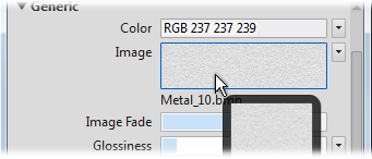

Custom color styles with texture maps may require some additional texture modifications. Adjusting textures requires being in the Appearance Editor or using the Appearance Editor documentation in-canvas tools. We will consider how this is done using the Appearance Editor and picking up the process from where it was in the previous question.
- In the Appearance Browser, edit the custom appearance.
- In the Appearance editor, click the Image preview to access the Texture Editor.
- In the Texture Editor you can: switch images, modify the Position, Scale, and Repeat values. In this instance, Scale needs to be modified.
