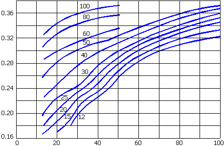

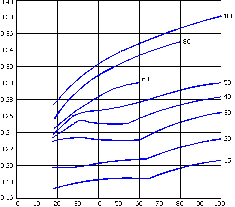

For standard spur gears (based on tooth fillet radius = 0.35/P). From AGMA Information Sheet 225.01.
Number of teeth in gear for which geometry factor is desired
|  | Number of teeth in mating gear. |
