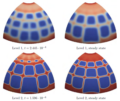

In this problem, a thin, hemispherical shell is examined. The shell has a hole opening at the top, around which a pressure load is applied. The y-displacements are fixed on the bottom edge of the hemisphere. The x and z-displacements are fixed around the hole opening on the top of the hemisphere [3].
Using Shape Generator, we are able to reproduce the published result. While much of the generated result agrees with the published results, some noticeable differences occur on the bottom edge of the hemisphere. In the Shape Generator result, only a thin layer of material is remaining where the boundary conditions are applied. The published results show a much thicker band of material around the bottom edge of the hemisphere. The published results also show some variance in thickness of this band of material, likely due to the symmetry boundary conditions used.
