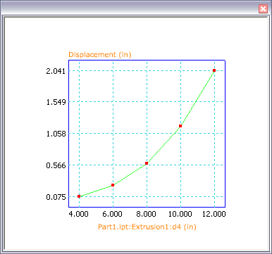

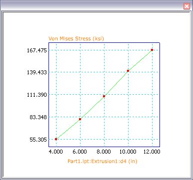

Display XY plots
In parametric studies, you can view the results as a two-dimensional XY plot.
  1. In the browser, select the Results type (Von Mises Stress, Displacement, and so on) that you want to see in a plot.
  2. Right-click the parameter row, and click XY Plot. A separate window displays the XY Plot.
The following image from the same simulation displays the XY Plot for Displacement results rather than Von Mises Stress.

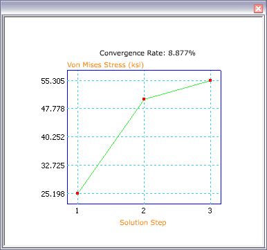

Display convergence plots
Define the convergence criteria that is used to reach a solution. The resulting convergence plot, shows the number of refinements used and the parameter values associated with each refinement.
To view an XY plot of the result convergence, in the Convergence Settings, set the Maximum Number of h Refinements to greater than zero.
  1. In the browser, click the node for the Results folder, and click Convergence Plot .
  2. In the Prepare panel, click Convergence Settings .
  3. In the Convergence Settings dialog box, specify:
    Default is 0. Value increment is 1.
    For values higher than 2, a dialog box displays. Increasing the number of refinements could decrease performance.
    If the Stop Criteria is met, the refinements can cease before the maximum number is reached.
    Stop Criteria (%)
    Ceases refinement when the difference between the last two results is less than the specified (%) value.
    h Refinement Threshold (0–1)
    0 means include all the elements in the set as candidates for refinement. The results are the maximum refinement per cycle. One means exclude all elements in the set from refinement, as in no refinement. The default is 0.75, which means, of the elements with equivalent errors at the top, 25% are subject to refinements. Not applicable to Modal analysis.
    Value increment is 0.1.
    Results to Converge
    • Von Mises Stress
    • 1st Principal Stress
    • 3rd Principal Stress
    • Displacement
    In Modal analysis only, Frequency Mode Specifies the mode number for results convergence.
    Geometry Selections
    Specifies the geometry to consider for the convergence criteria.
  4. In the Solve panel, click Simulate. Let the simulation complete.
  5. In the Result panel, click Convergence Plot.
