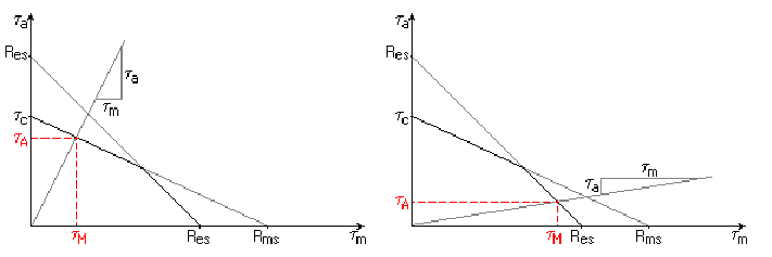

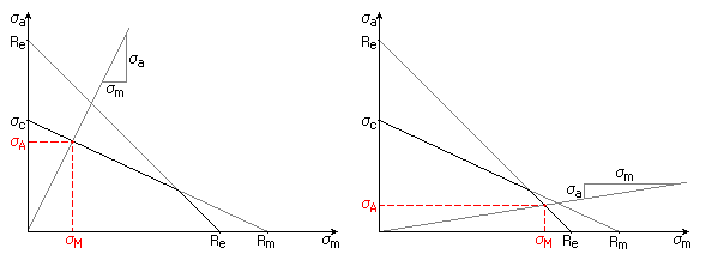

6. Specifying fatigue strength of joint
For calculated stress and known endurance limit, the resulting strength of fatigue joint is easily determined according to the selected fatigue curve. The procedure of fatigue strength determination for both normal and shear stresses is obvious from the following pictures.
Haigh charts of normal stress for different σ a / σ m ratio (modified Godman fatigue curve is used):
Haigh charts of normal stress for different τ a / τ m ratio (modified Godman fatigue curve is used):
