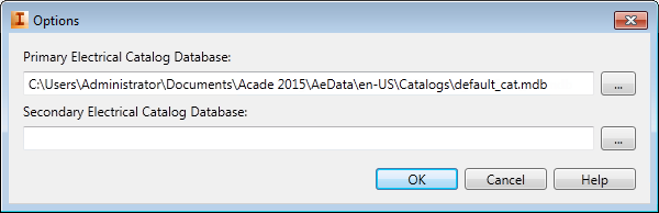

Options Dialog Box (Electrical Catalog Browser)
 Ribbon:  Assembly tabComponent panelPlace drop-downElectrical Catalog Browser.
Click .
List of Options
The following options are displayed.
Primary Electrical Catalog Database
Defines the folder and name of the catalog database. By default it is the catalog database installed with AutoCAD Electrical.
Secondary Electrical Catalog Database
Defines the folder and name of the optional secondary catalog database. A common use for a secondary catalog database: the primary file can contain the catalog information that you commonly use, and the secondary file can contain the full list of catalog content available.
