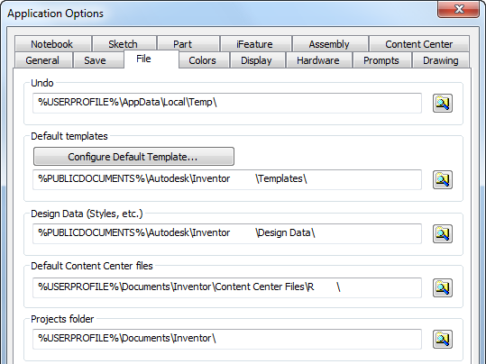

By default, the style library supplied with Autodesk Inventor is in the C:\Program Files\Autodesk\Inventor <version>\Design Data folder or in the C:\Users\Public\Documents\Autodesk\Inventor <version>\Design Data folder. The style library location is also available from the Application Options, File tab. If you work in a networked environment, this folder resides in a shared location on the network, and not on your local hard drive. If you are unsure of this location, check with your IT or CAD Administrator.

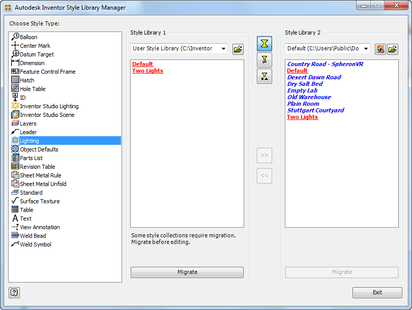

- On the Start menu, click All Programs > Autodesk Inventor <version> > Tools > Style Library Manager.
- The Inventor Style Library Manager dialog box displays.
- In the Style Library 1 pane, use the browser button to navigate to the folder where older style collections (in .xml format) are located. By default, the folder location is C:\Program Files\Autodesk\Inventor <old version>\Design Data or C:\Users\Public\Documents\Autodesk\Inventor <old version>\Design Data. You also can click Open Style Library to select specified old style library folder.
- The Style Library 2 pane also provides a browser button to navigate to the location of the new style library. By default, the folder location is C:\Program Files\Autodesk\Inventor <new version>\Design Data or C:\Users\Public\Documents\Autodesk\Inventor <version>\Design Data. You can click Open Style Library to select specified new style library folder.
- In the example shown in the previous image, the Lighting style collection is selected from the Choose Style Type: list at the far left of the dialog box. Also, both the old and new style library folder locations are selected using the appropriate browser button. Their contents appear in the left and right panes respectively, and the old style library pane [Migrate] button is highlighted.

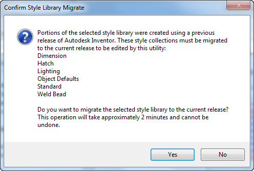

- To start the styles migration, at the bottom of the Style Library 1 pane, click Migrate. (Enabled only when a library requires migration.) The Confirm Style Library Migrate dialog box displays, prompting you to confirm the migration. Click Yes or No as appropriate.

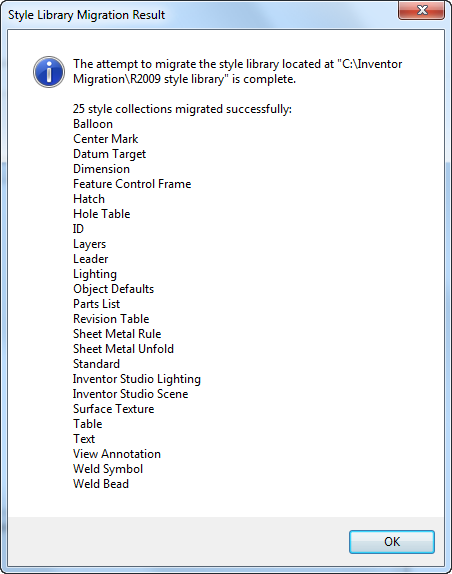

- The migration process takes a minute or two. When it is complete, a dialog box displays the results of the migration. Click the OK to close the dialog box.
Note: The style migration cannot be undone, and any user edits to the style library are lost. You can restore them from your backup.
Filter Buttons
There are three ways in which style collections are listed in the style library panes. These methods are controlled using the filters located at the top center of the Style Library Manager dialog box:
Show All Styles Active by default. Lists all styles in both style libraries. Style definitions that are identical between the two libraries display in a regular black font.
Show Mismatched Styles Shows the styles with definitions that differ in the two libraries. With this setting, the style names are underscored and display in red.
Show Unique StylesShows styles that exist in one library, but not in the other. With this setting, the style names are italicized and display in blue.
