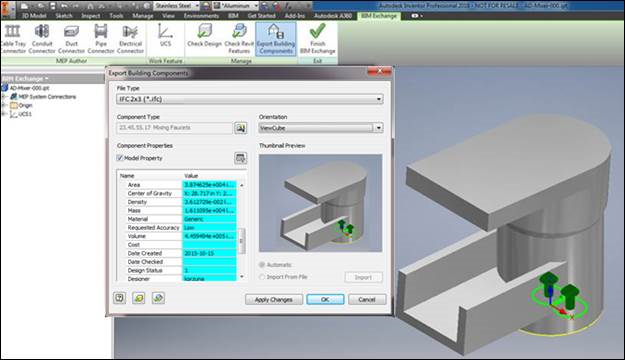

The Industry Foundation Classes (IFC) file format provides an open standard means of exchanging model information between manufacturing, architecture, engineering, and construction industries. Autodesk Inventor 2016 R3 adds the IFC format as an export option to facilitate the delivery of 3D mechanical designs for building and construction applications.
The IFC standard is developed and maintained by buildingSMART. Autodesk has supported the buildingSMART initiative on COBie (Construction Operations Building Information Exchange) BIM data standard since its inception and is also on its board. Inventor leverages buildingSMART-certified IFC export capabilities in Revit to provide this capability.
From a part or assembly file, select the IFC file format from the 'Export Building Components' command within the BIM Exchange environment. The model will be written into a *.ifc format and will contain 3D geometry and material property information for use downstream.
