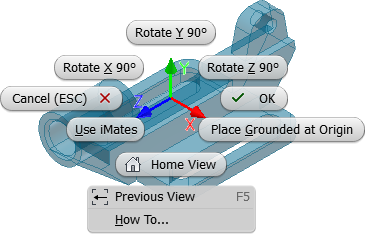

A new assembly application option specifies whether to ground the first placed component at the origin. This new option is turned off by default. To ground any component at the origin, use the context menu. The menu contains new options to rotate components in 90-degree increments about the X, Y, or Z axis, before you place them in the assembly.

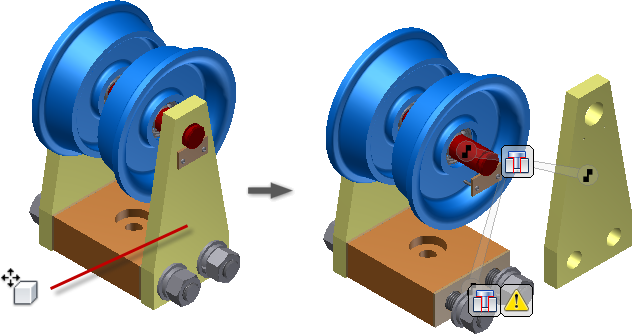

With the Free Move command, display relationships as an elastic band, and visualize and manage relationships in a new way. Click a relationship icon, and then, to suppress, unsuppress, or delete relationships, use the context menu.

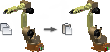

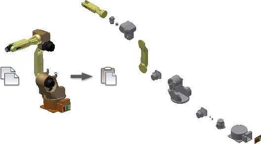

In previous releases of Inventor, a copy and paste operation did not retain component connections or current orientation.
The enhanced copy and paste operation produces a duplicate of the copied components with connections and orientation intact.

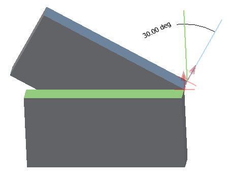

The Symmetry constraint positions two objects symmetrically according to a plane or planar face. The Symmetry constraint is available in the Place Constraint dialog box.
When you create an angular constraint, the status bar displays clear instructions to finish the Constrain command.
Angular constraints display direction vectors and the angle in the graphics window.
The model preview updates when the Angle value changes.

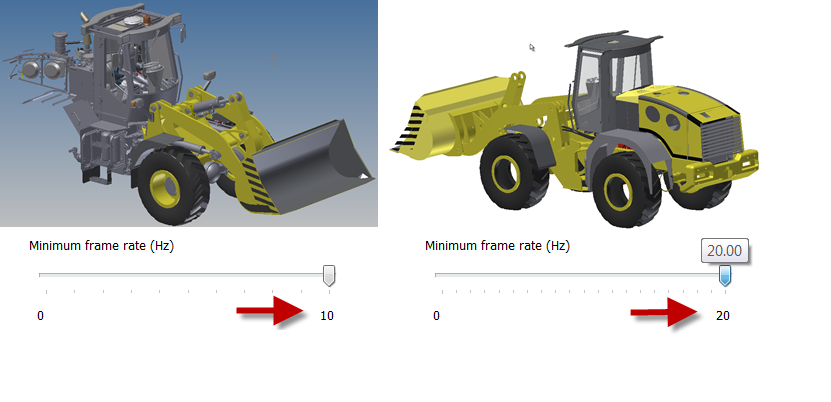

Express mode introduces a new way of working with large assemblies. Large assemblies typically open 4-6x faster, dramatically improving your time to work.
Enable the Express option and set the unique files threshold in the Application Options, Assembly tab. Large assemblies that exceed the threshold open automatically in Express mode.
Load Full
to exit Express mode and enable all commands.
In the following images, the 2013 model on the left displays the results of rotating the model using the maximum of ten frames per second. Increasing the frame rate increases the speed, but the choice of components to draw is not intelligent. The 2014 model on the right shows the results of rotating at the faster maximum frame rate of 20 Hz. The model remains recognizable, and all view operations are faster.

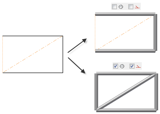

In previous versions of Inventor, construction lines and center lines are automatically included, and frame components are created from them.
In the current version, you can exclude construction lines or center lines from the geometry selection used to create frame components.
On the ribbon, click
Design tab
Frame panel
Insert Frame
. Then, in the Insert dialog box, select or clear the Select Centerline, or Select Construction options to specify your settings.

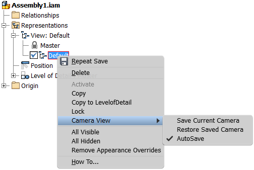

In previous versions of Inventor, the camera position is always automatically saved on closing the design view representation. When you rotate or zoom the model in a design view, tools to restore the previous camera settings are limited.
With new commands in the view representation context menu, you can easily save and restore the camera settings.
