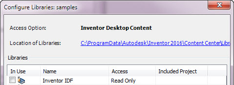

You now have more flexibility and control when working with PCB design data. The enhanced support for IDF 2.0 and 3.0, includes new controls over importing design data, as well as a new ability to publish to the new IDF Component Content Center library and reuse PCB components.
New IDF Component Content Center Library
A new Content Center library for IDF components installs with the 2016 R2 (Subscription only) release.
Author
IDF Component command to the new IDF Component Content Center Library.
New IDF Import options and workflow
to identify any components that are not already in the Content Center library. In the new Components Not Found dialog box, select Copy to clipboard to copy the file names to easily identify parts for publishing.
To add these parts to the IDF Component Content Center Library, open each part and use the Manage
Author
IDF Component command to publish to the new IDF Component Content Center Library.
