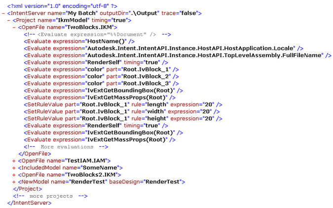

A task file is an XML document. It specifies Intent Server actions during batch processing.
The XML root element is <IntentServer >. The children element, <Project > specifies the Inventor project contexts in which the model runs.
Within the project, you specify models in one of the following ways:
- <OpenFile > Stores the model in a text file, or inside an Inventor assembly file (IAM).
- <IncludedModel > Embeds the model in the task file itself.
- <NewModel > - Creates an empty model.
Within the Model tags, the following children are available:
- <Evaluate > Evaluates an Intent expression.
- <SetRuleValue > Modifies an Intent Rule formula.
The batch processor ignores all other elements in the task file. When batch processing finishes, the processor adds details about the evaluation and the results to the task file. The information about the specific steps is saved in attributes of the XML structure.

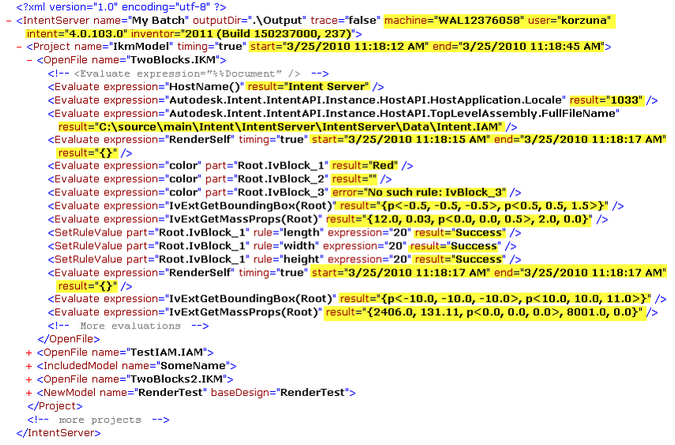

Example task for batch processing by Intent Server
The output XML is saved into “.\output” directory. The details on every operation are highlighted:
