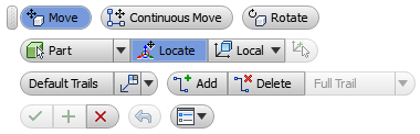

Tweak Components Minitoolbar
Tweak command is redesigned to use direct manipulation tools arranged in the Tweak Components minitoolbar.
The Tweak Components minitoolbar includes many new commands.

Move and Continuous Move
Two options are available to create transitional tweaks:
  • Move clears the selection set of components when you click Apply. You can create a sequence of tweaks with a different selection sets.
  • Continuous Move retains the selection set of components after you click Apply. You can add multiple tweaks for the same selection set, or slightly change the original selection as you create tweaks.

Default Trails
When you create a tweak, you select an option to create default trails:
  • None cancels creating trails.
  • All Components creates trails for all selected components.
  • All Parts creates trails for all selected parts, excludes subassemblies from creating trails.
  • Single creates a single trail for the entire tweak regardless of the number of moved components. The trail starts from the triad location.

Manual Trails
When the default trails do not match your needs, you can add trails or trail segments manually. On the Tweak Component minitoolbar, click Add , and select Full Trail or Trail Segments. Then in the graphic window, click a point on the tweaked component to add a trail.
Note: A full trail denotes a complete component path in a presentation view. A trail segment represents a specific translational or rotational tweak.
