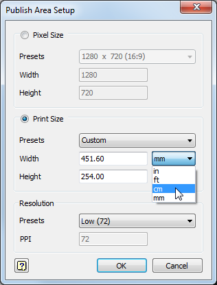

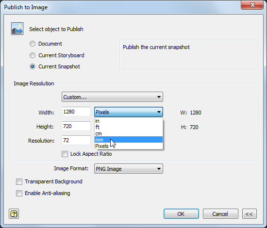

When you specify size of the Inventor Publisher output, you can set units for the dimensions of the published area. The following units are available: Inches, feet, millimeters, and centimeters.
The unit setting is available in two dialog boxes:
Publish Area Setup dialog box, Print Size area
Publish to Image dialog box, Image Resolution area
