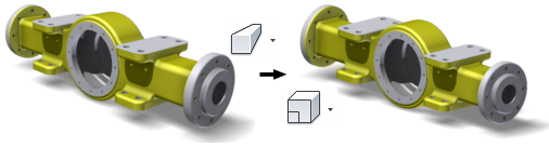

In Orthographic Camera mode, a model displays so all its points project along parallel lines to their positions on the screen. All same-length parallel edges display as the same length, even when you orient them so one edge is closer to you than the other. In Orthographic Camera mode, a 3D model appears flat and unlike objects observed in the real world.
Use Orthographic Camera mode to confirm visually or compare the relative dimensions of entities.
