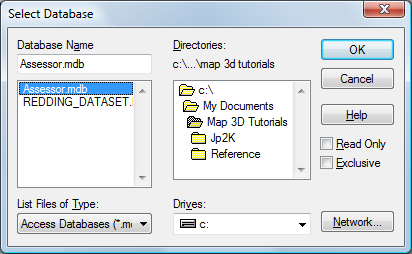

- Under Database, click Select.
- In the Select Database dialog box, navigate to the sample files and select the Assessor.mdb file.
Specify the database for this data source.
- Click OK in the Select Database, ODBC Microsoft Access Setup, and ODBC Data Source Administrator dialog boxes.
