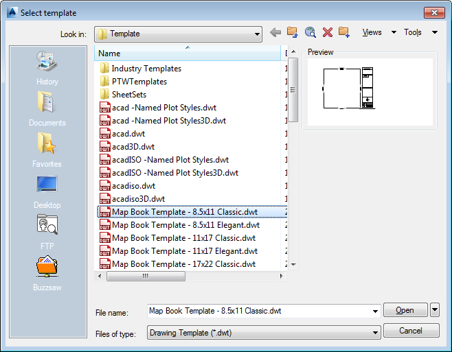

  1. Open the 8.5x11 map book template.
    • Click OpenDrawing.
    • Change Files Of Type to Drawing Template (*.DWT).
      AutoCAD Map 3D automatically changes to the Template folder.
    • Scroll about halfway down the list of templates.
    • Select Map Book Template - 8.5x11 Classic.dwt.
    • Click Open.
      Scroll halfway down the list of templates and select the first map book template.

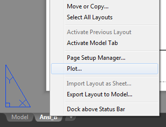

  3. Right-click the layout tab labeled Ansi_A and select Page Setup Manager to specify plotter and paper information.
    Right-click the layout tab for the map book and choose Page Setup Manager.
