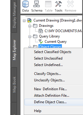

  2. On the Map Explorer tab of the Task Pane, right-click Object Classes and click Attach Definition File.
  3. Specify the MyDefinition.xml definition file you created.

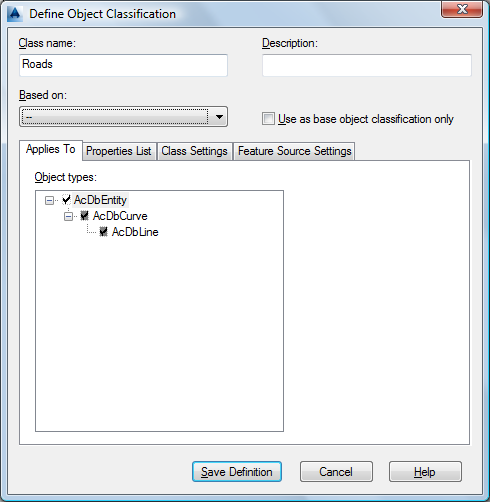

  6. In the Define Object Classification dialog box, specify Roads as the name for this object class. Select the topmost box in the Object Types list (AcDbEntity).
    Specify the object creation method that existing objects must use to belong to this object class.
    All existing objects you add to this class must use the object type you check here. Unless you know for certain that all existing road objects were created using the AcDbLine or AcDbCurve method, it is safer to check only AcDbEntity .

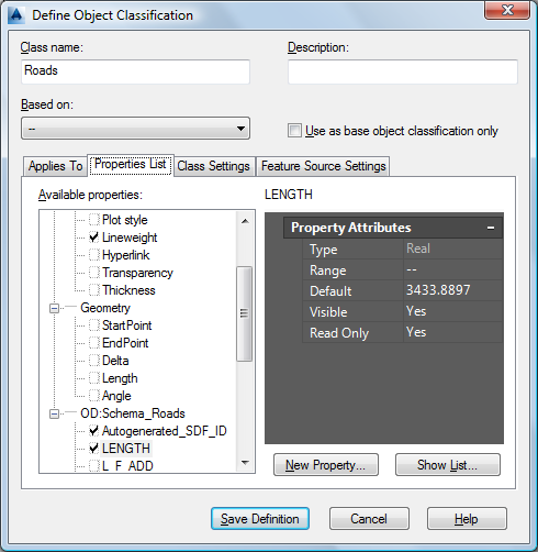

  7. Click the Properties List tab and check the properties to include in this object class.
    Objects you include in this class always retain their own properties. The properties you specify here are the properties of the class as a whole. Choose properties to set their default values or allowable ranges, or to make them editable for all members of the class.
    For example, to be able to change the layer, linetype, or color for all members of the Roads class as a group, select those properties. You can set default values, where appropriate. For example, you can assign all members of the Roads class to a Roads layer.

  8. Specify the object data (OD) fields and their values.
    For object data fields, clear the values that are specific to the model object you chose. For example, include the NAME and ST_NAME properties to ensure that all new roads you create contain those properties. Delete the values that appear there, because each new road name will differ from the name of the model object.
    For example, click the ST_NAME property and look at its values. The default value for the street name is the name of the model object. This value is incorrect for almost any new road you create. Select that value and delete it.
    Objects assigned to this class have a ST_NAME property, but the value will be the name for that road (as stored in its object properties). If no value exists, the property is blank. The following table shows a suggested set of OD:Schema_Roads properties and values for the Roads class.
    Property Value
    Autogenerated_SDF_ID No value
    LENGTH No value
    NAME No value
    PREFIX No value
    SEG_ID No value
    ST_NAME No value
    ST_TYPE No value
    SUFFIX No value
    TYPE No Value

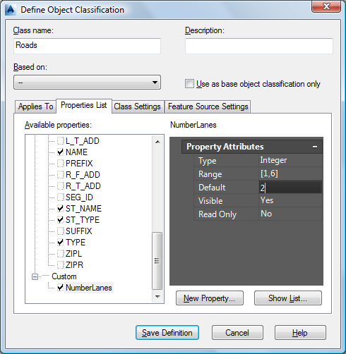

  9. To add a new property that specifies the number of lanes for a road, do the following:
    • Click New Property.
      Define any custom properties for the object class.
    • For Property Name, type NumberLanes and click OK.
      NumberLanes is checked and selected.
  10. Specify that NumberLanes is a whole number from 1 through 6, with 2 being the default:
    • For Type, select Integer.
    • For Range, type [1,6].
    • For Default, type 2.
