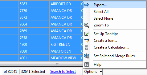

Display the Data Table for the construction-zone parcels. Export the data to a comma-separated file. You can use the data in any way you like. For example, use it in a report, or to create a mailing list for the owners of the construction-zone parcels.
This exercise uses the AnalyzeMap1.dwg map you created and modified in the previous exercises.
To export the construction-zone parcel data
Export property information from the Data Table.
You exported information from the Data Table as a comma-separated file that can be used to generate a report.
