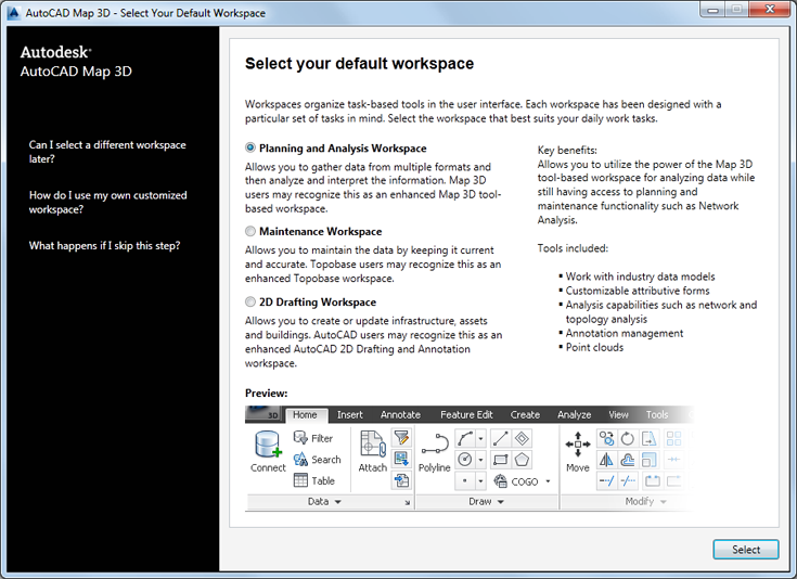

Choose your default workspace when you first start AutoCAD Map 3D.
Select a default workspace on startup or from the Help tab.
Switch to another workspace if you need to.
Within a session, you can switch between workspaces.
