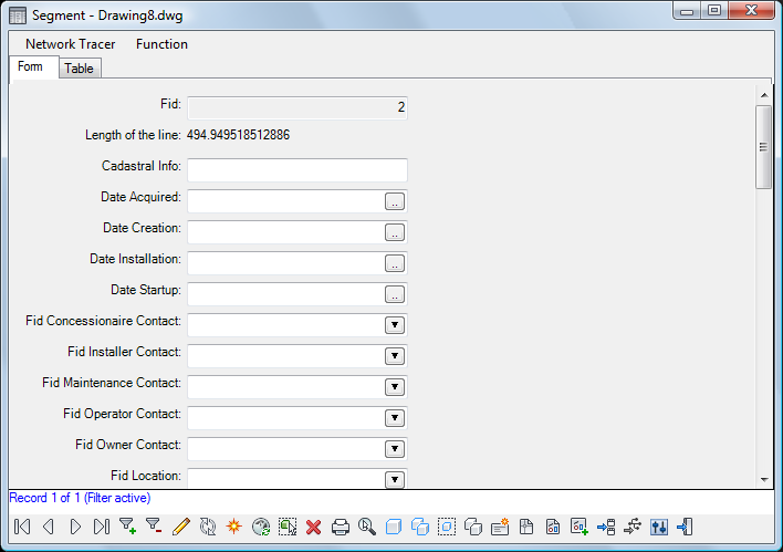

When you use an industry model drawing , you can also use forms to edit attribute data for individual features.
Forms display attribute information for a single feature.

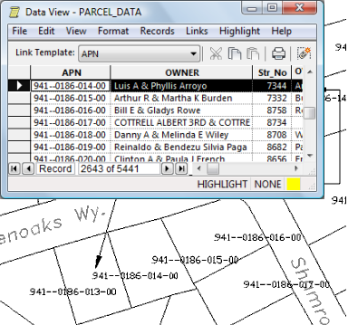

Using the Data View, you can sort and filter the external database records linked to drawing objects. In addition, if you open the table in Edit mode, you can edit the data in the database table.
Data View displays external data linked to a drawing
To use the Data View
