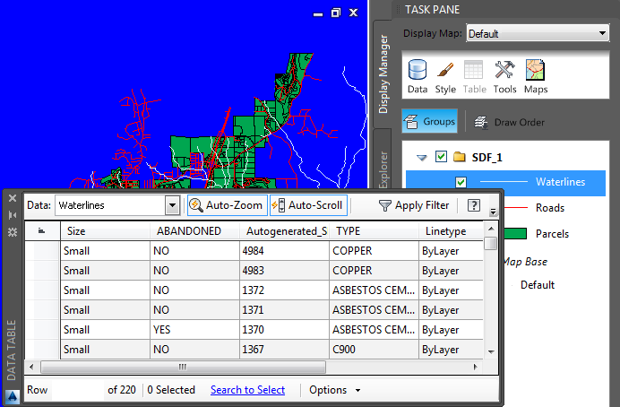

To examine the attribute data
In this example, the Data Table was undocked by dragging it away from the edge of the window.
The general properties and the object data specific to Waterlines appear in the Data Table.
The .COLOR properties have been translated to a new Size property.
