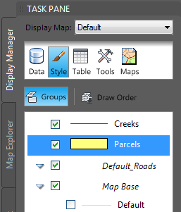

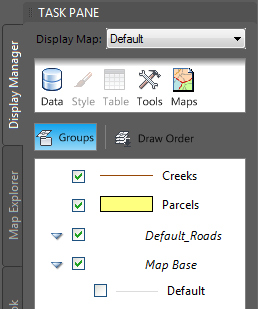

The Display Manager tab shows the layers in the current map.
Click the Parcels layer and then click Style.

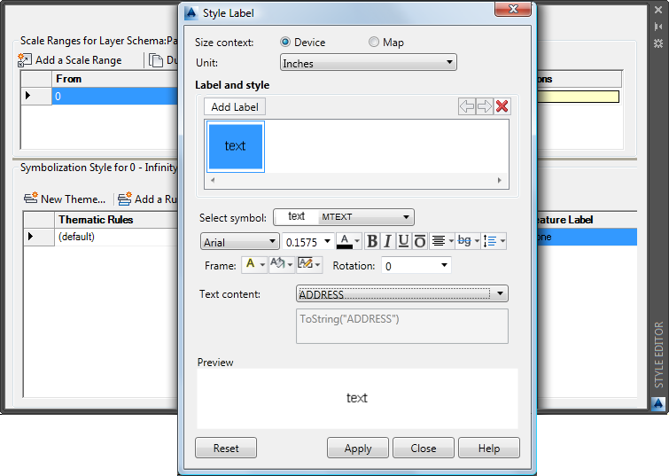

Click the cell under Feature Label. Specify the property to display in the label and some styling options.
Labels display street numbers on the parcels in your map.
