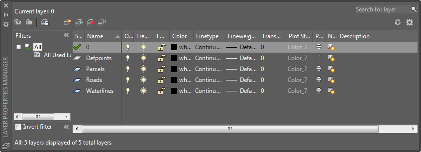

    The DWGMap.dwg drawing has multiple drawing layers.
  4. In the Click Home tabAutoCAD Layers panelLayer Properties. Examine the drawing layer information.
    The layers in the drawing are listed, along with their properties.
