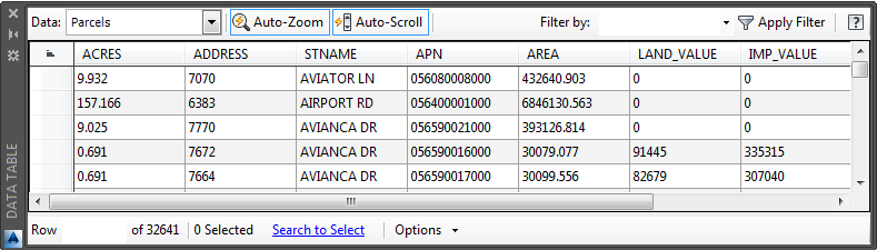

Now, add a layer that displays parcels in one part of the city of Redding. This layer contains size, value, and address information about the parcels. It does not contain information about the owners. You join to a data source that contains that information later.
When you make the parcels semi-transparent, you can see the other features underneath.
This exercise uses the AnalyzeMap1.dwg map you created and modified in the previous exercises.
To add the parcel layer to the map
.Information associated with the parcels is displayed, but the information does not include owner-related data.
Data associated with the Parcels layer is displayed.

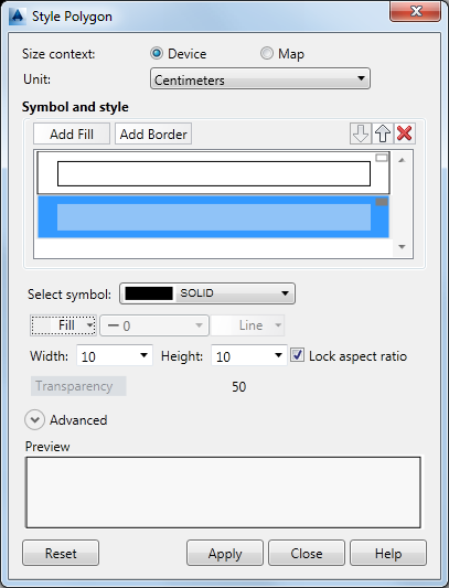

To style the parcels in the map
Change the foreground transparency for the parcel layer.
The parcel layer is draped over the surface. Because it is transparent, you can see the surface underneath.
