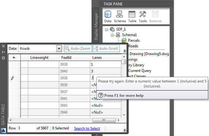

After you add a property to a feature class, you enter the values for that property for each feature in the feature class.
This exercise uses the map you modified in Exercise 4: Add a property.
To populate the new properties with data
If you enter a value that is outside the allowable range and click outside the field, a warning is displayed.
You connected to the SDF file you created earlier and added a new property to its schema. You entered values for the new property in the Data Table.
