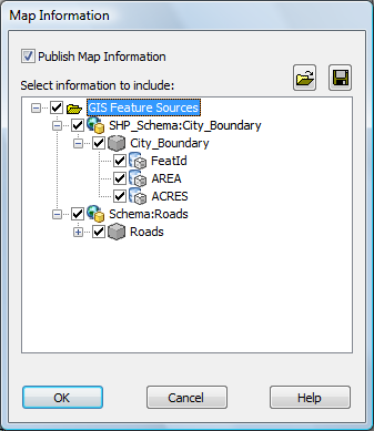

  2. Click Output tabExport To DWF/PDF panelDWF Options. Find
  3. Select the Publish Map Information check box.
  4. Expand the GIS Feature Sources item to see what is included.
    If you expand the list all the way, you can see the properties associated with the features in this map.
  5. Check the GIS Feature Sources item.
    All subitems are automatically checked.
    The Map Information dialog box determines which data is published to DWF
    Optionally, you can select just a subset of the properties.
  6. Click OK.
