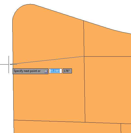

You interactively divide a parcel into two unequal closed polylines.

New splits this parcel in two pieces. You can create more pieces by selecting Multipart.
You can specify the default values for two of these prompts in the Feature Editing Options dialog box. You can turn off the prompts and always use the default values. In that case, you see only the third prompt and not the first two.

When you specify the last point and press Enter, the parcel is split.
