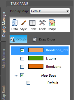

The map now displays the two original layers and a new layer, representing the overlay.
Hide all the layers except the overlay.
