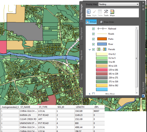

Connect to the data from the Task Pane.
  • Select the data source.
  • Select the feature classes to add to your map.
  • Each feature class you add becomes a layer in the Display Manager.
The layers in Display Manager represent the data sources to which this map is connected. The Data Table lets you edit the information for individual items in a layer.

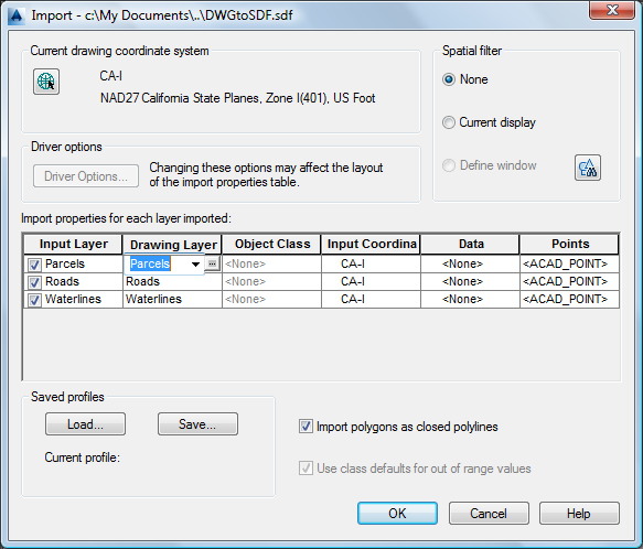

Import Data
You can import data, rather than connecting to it. Importing breaks the connection to the source and adds a “snapshot” of the data to your map. If the data changes after that, you will not see any changes in your map unless you import the data again. There is no way to update imported data in its source. Similarly, when you export data, you export the current data only. The connection to the live data is lost.
When you import data, you can structure it in your map. Assign data to layers or object classes. Add attribute data to object data tables. Assign a coordinate system. Specify that points come in as points, text, or blocks.
You can read, write, and convert data between standard formats.

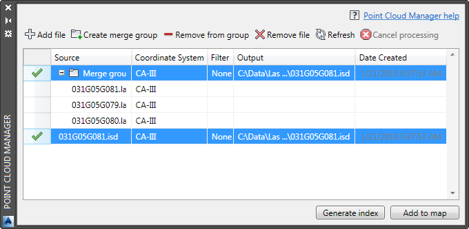

Add Point Cloud Data
Bring in point cloud data from LiDAR Aerial Survey (.LAS) files or ASCII (.XYZ) files.
Use the Point Cloud Manager to bring in point cloud data
