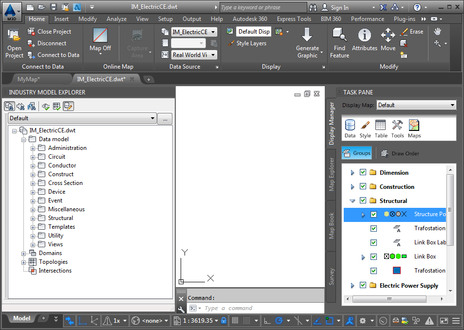

Industry model templates contain feature classes and rules for a specific industry. Industry models use rules and relationships to ensure that features match certain standards. Even if you do not store your data in a relational database, you can use an industry model drawing to practice rule-based drafting. For example, if a rule specifies that all transformers must be located on poles, the model will ensure that you do not create a transformer in any other location. In this way, industry models are similar to drawing classification. For more information, see About File-based Industry Models.
Industry model templates display the data model in the Industry Model Explorer on the left and a set of predefined industry-specific feature classes in the Task Pane on the right. The Maintenance workspace ribbon is optimized for an industry model.
