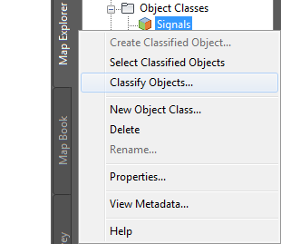

  3. Right-click the Signals object class in Map Explorer in the Task Pane and click Classify Objects.
    Classify the selected objects if they meet the criteria of the object class.

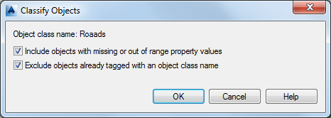

  4. Leave both boxes checked in the Classify Objects dialog box and click OK.

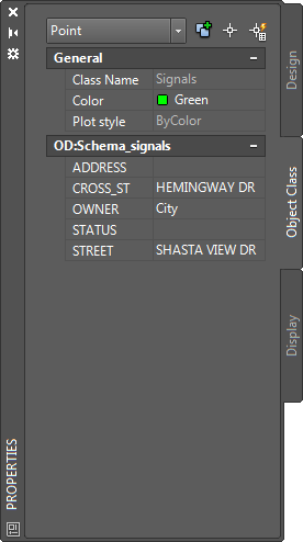

  6. Press Esc again to clear the selection, and then click a single signal to select it.
  7. Right-click the selected signal and click Properties.
  8. On the Properties palette, click the Object Class tab and examine the properties.
    Examine the properties for members of the Signals object class.
