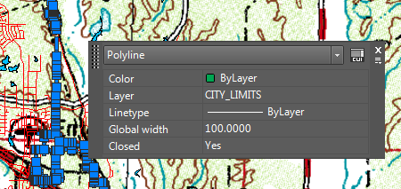

  3. Click the polyline to select it.
    If the Quick Properties panel is not displayed, right-click anywhere in the drawing and select Quick Properties.

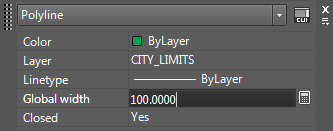

  4. Select the value for Global Width, enter 100, and press Enter.
    You can edit values in the Quick Properties window.
  5. Press Esc to close the Quick Properties window.
    The polyline displays at the new width.
