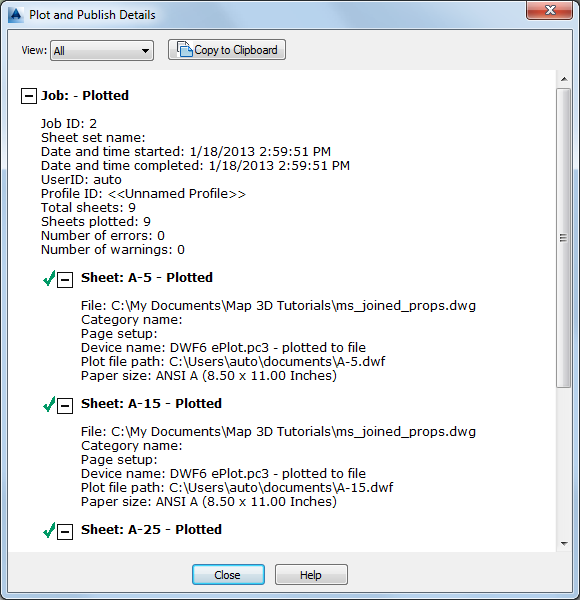

  5. If you see the message that tells you the job is processing in the background, click OK.
    Notice the animated icon in the lower right corner of the window.
    Place your cursor over the animated icon to see which page of the map book is being published.
    When the job is finished, a message alerts you to any errors.
    You can view the details
