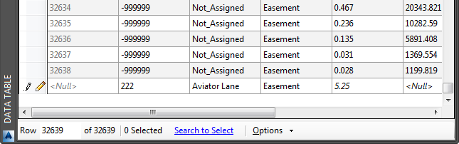

In the Data Table , add information about this parcel.
If you are connected to the internet, play the video to see how to add property values to the new parcel. You can also click "Let Me Try" to try it yourself. The steps for this procedure are listed below the video. |
To add information about the new parcel
The original data source is updated.
If the Data Table is minimized or docked, click its Show/Hide icon to display it. Scroll to the bottom of the Data Table to see the new entry.
Look at the other entries to see what a logical entry would be for each column. Making changes to the parcel properties checks the parcel out automatically.
The original data source is updated with your changes.
You have added a new parcel and updated the parcel data to reflect your changes.
A new Data Table entry
