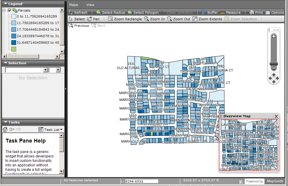

You can share maps even with viewers who do not have access to AutoCAD Map 3D. For example, you can share maps in the following ways:
Publish to Infrastructure Map Server to share a map on the web.
