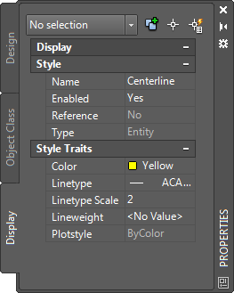

All the properties of the style are displayed on the Display tab of the Properties palette, where you can view or modify them.
