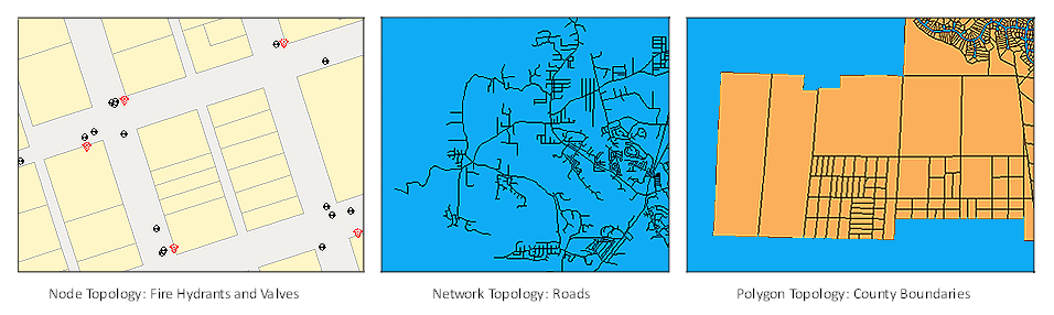

Using AutoCAD Map 3D, you can create node, network, or polygon topologies.
Node Topologies
- Define the interrelation of nodes (point objects).
- Are often used in conjunction with other topologies in analysis.
Network Topologies
- Connect links (lines) to form a linear network.
- Links can connect nodes.
An example of network topology is a water-distribution application that traces the flow of water from a pumping station to residences. A street network is another example. For network topologies, you can specify the direction for a link and specify the resistance for a link or node.
Polygon Topologies
- Define polygons that represent enclosed areas such as land parcels and census tracts. A single link defines the common boundary between adjacent areas.
Uses of polygon topology include tax assessment and land planning in which parcels of land are represented by polygons. Political boundaries, such as voting districts, city, state, or provincial boundaries, special districts, and school districts, are other examples of the use of polygon topology.
