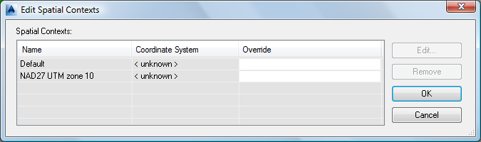

When you add data to your map, you must specify its original coordinate system. AutoCAD Map 3D automatically converts the data from that coordinate system to the one specified for your map.
- Click Edit Coordinate Systems and, in the Edit Spatial Contexts dialog box, click the entry and click Edit.
Select the entry and click Edit to specify the coordinate system for the surface
- Select the coordinate system you saw in the pop-up window. Click OK twice to return to the Data Connect window.
