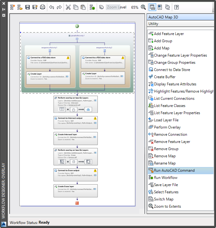

Use the Workflow Designer to create or edit the sequence and parameters for the activities in the workflow.
You can run built-in or custom workflows. The built-in workflows include:
- Overlay: Connect to (and create layers for) two data stores. Perform an intersection overlay. Use the result of that overlay operation to erase the portions of the layers that were within the intersection.
