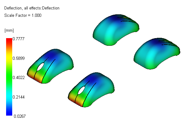

  1. Ensure that just the Parts and One Part layers are selected, and that all other layers have been deselected.
  2. Rotate, the model so the rotation is -45 35 30, and the view cube looks similar to the image.
  3. Click the Deflection, all effects:Deflection result in the study tasks list.
    This result shows the warpage on all four parts. The warpage looks about the same.

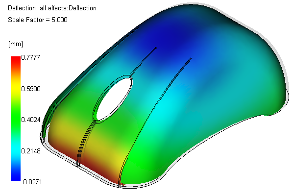

    The deflection of the two buttons has a deflection that is nearly double the outside edges of the part.

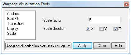

  6. Click (Results tab > Warpage panel > Visualize).
    1. Click Scale.
    2. Enter 5 as the scale factor.
    3. Ensure that only the X and Y Scale Directions are selected.
    4. Pick Apply on all deflection plots in this study from the list.
    5. Click Apply.
    6. Click Close.
This tool scales the results 5 times so the deflection is easier to see.
