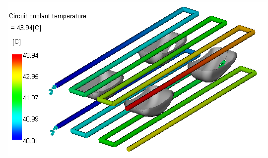

  3. Click the Circuit coolant temperature result in the study tasks list.
    An increase in temperature more than 2-3°C is a problem. The core is slightly more than the guideline.

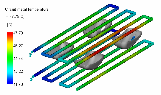

  6. Click the Circuit metal temperature result. The circuit metal temperature is best when less than 5°C above the coolant inlet temperature, in this case 40°C. Both the circuit coolant temperature and the circuit metal temperature indicate a problem.
