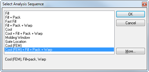

Set the Analysis Sequence
In this task, you will set the analysis sequence to Cool(FEM) + Fill + Pack + Warp.
  1. Click (Home tab > Molding Process Setup panel > Analysis Sequence).
  2. Select Cool(FEM) + Fill + Pack + Warp.
    Note: If you do not see an analysis sequence, click More to see all that are available for the molding process.
  3. Click OK.
