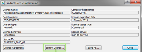

  1. Click Help > About Autodesk Moldflow Insight 2016 > License Information .
  2. In the Product License Information window, click Borrow License.

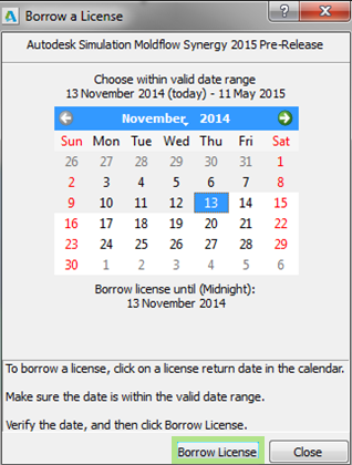

  3. In the Borrow a License window, on the calendar, click the date on which you would like to return the license.
  4. Click Borrow License.
  5. In the License Borrowed message, click Close. The license is borrowed and you can now use it with your computer disconnected from the network.
You can return the license sooner than planned by clicking Help > Autodesk Moldflow Insight 2016 > License Information to open the Product License Information, then clicking Return License.
