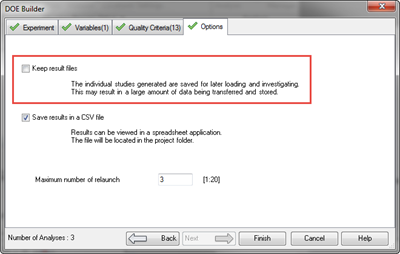

In DOE and parametric study analyses, there is an option to Keep result files in the Options tab of the Builder. For very large studies, this has occasionally resulted in problems when the resulting *.od4 file was too large for the unzip utility.
The ZIP archiving utility has been updated to support file sizes greater than 4GB.
This upgrade has the following benefits:
- All analyses that were readable in previous releases will still be readable in this release, without the need to rerun the analysis
- All analyses that were run in a previous release, but which produced *.od4 files greater than 2.1GB and were therefore not readable, will be readable in this release, without the need to rerun the analysis.
