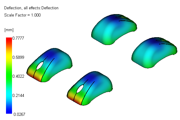

Ensure that just the Parts and One Part layers are selected, and that all other layers have been deselected.
Rotate, the model so the rotation is -45 35 30, and the view cube looks similar to the image.
Click the Deflection, all effects:Deflection result in the study tasks list.
This result shows the warpage on all four parts. The warpage looks about the same.

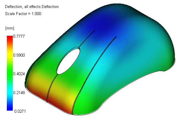

Uncheck the Parts layer.
Zoom up on the remaining part.
The deflection of the two buttons has a deflection that is nearly double the outside edges of the part.

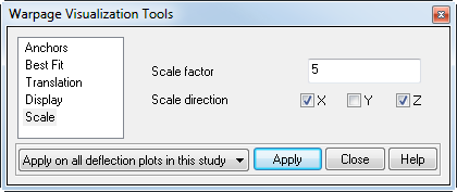

Click
Click Scale.
Enter 5 as the scale factor.
Ensure that only the X and Y Scale Directions are selected.
Pick Apply on all deflection plots in this study from the list.
Click Apply.
Click Close.

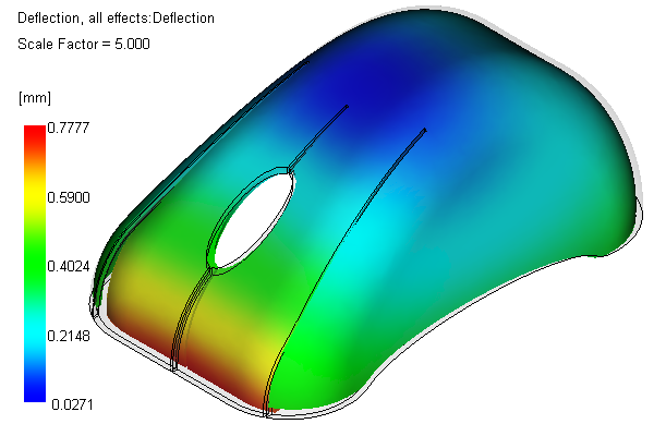

This tool scales the results 5 times so the deflection is easier to see.
