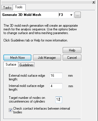

  2. Click (Mesh tab > Mesh panel > 3D Mold Mesh).
  3. Enter 16 mm for the External mold surface edge length.
  4. Enter 4 mm for the Internal mold surface edge length.
  5. Enter 12 for the Target number of nodes on circumferences of cylinders.
  6. Click Mesh Now.

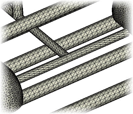

  7. When the meshing is complete, uncheck the Mold External Triangles layer.
  8. Inspect the mesh covering the cooling lines and part.

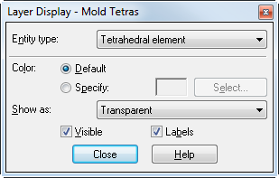

  11. Right click on the Mold Tetras layer and select Display.
  12. Set the Show as to Transparent, then click Close.
