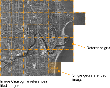

Raster (or image) files are pixel-based data, such as digital photographs, that you can use as backgrounds for feature and drawing data. For example, you can display an aerial photograph of a city under a layer of streets. Raster files are cataloged to optimize performance. You create a raster catalog as part of the load process.
The following table provides a brief description of the raster image file formats supported by Autodesk Infrastructure Studio:
