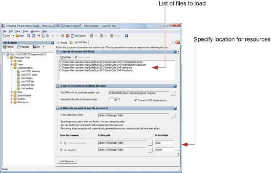

This procedure assumes that the necessary .shx and .dbf files are in the same folder as the .shp files. To load a shapefile, you drag the source file to the Site Explorer. Autodesk Infrastructure Studio automatically creates a new layer as well as a new feature source.
To load an SHP file
A new load procedure is displayed to the right of the Site Explorer. It contains a list of the files to load. You can drag other files into this load procedure.
The coordinate system you select here will be used only if there is no coordinate system already defined for the source file or files.

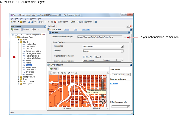

Autodesk Infrastructure Studio creates a new feature source and a new layer for each SHP file.
The Layer Editor is displayed to the right of the Site Explorer. (For more information about the Layer Editor, see Working with Feature Source Layers).
You can rename the new feature sources and the layers in the Site Explorer.
