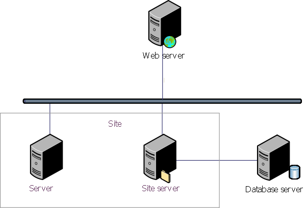

In the diagram, the site contains two servers, one of which is designated as the site server. The site server contains the resource repository. It also connects to any database server or servers.
Infrastructure Map Server provides seven services: Site, Resource, Drawing, Feature, Mapping, Rendering, and Tile. If you are using a single server, that server performs all of these services. In any case, the site server always runs the first two services, because they handle data access and manage the resources for the site. However, if you have two or more servers, you can split off the other services and allocate them to another server or servers. For example, the Mapping and Rendering services are the most processor-intensive operations and can benefit from having a dedicated server to handle them.
A typical site with two servers
