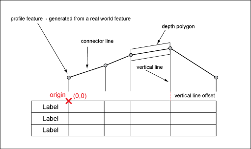

Profile feature classes store the points, lines, and labels for each profile. Profile feature classes represent two types of features:
A real world feature (parent), such as a manhole cover. Each real world feature corresponds to a profile feature. Real world features are profile objects that are normally displayed in the global reference system. The profile feature class stores the relation to the real world feature in the attribute FID_PARENT.
Decoration elements of the profile drawing, such as frame lines, legend, and fix labels. Decoration elements do not correspond to any real world features.
For example, a profile feature of WW_LINE_PRO stores the profile line that corresponds to a real world feature of WW_LINE.

| Vertical line | WW_PROFILE_LINE_PRO | detail |
| Connector line | WW_PROFILE_LINE_PRO | detail |
| Symbol such as origin, reference height | WW_PROFILE_POINT_PRO | detail |
| Polygon | WW_PROFILE_POLYGON_PRO | detail |
| Static text such as height, legend labels | WW_PROFILE_STATIC_TEXT | detail and sub detail |
